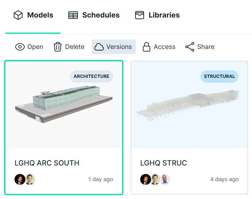

In the dashboard, head to the project model overview. Select a model and click the Versions button.

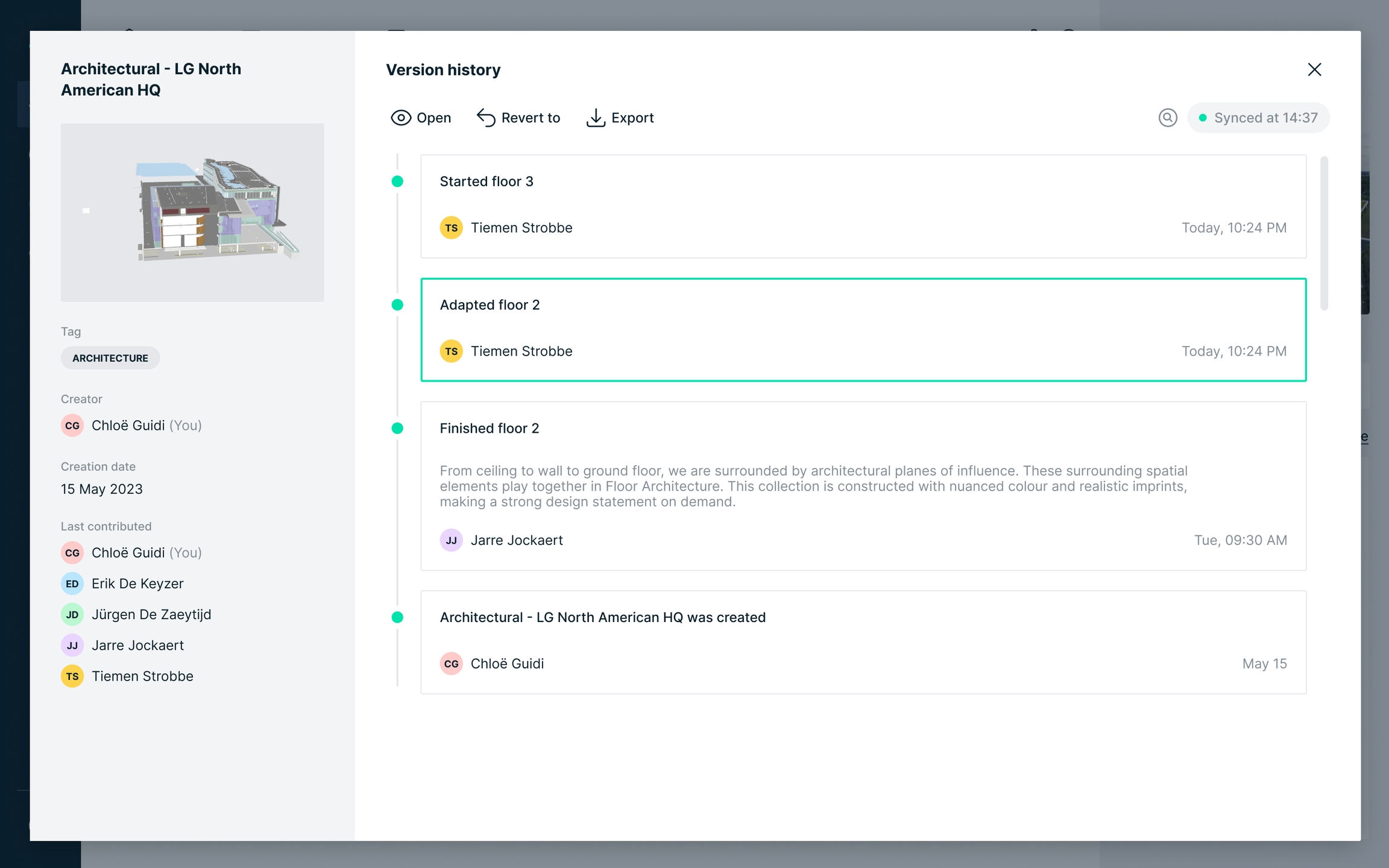

A dialog will open showing the full version history of the selected model, showing the most recent version at the top. Use the search field to find a version by title, description or author. You can select any version, and do any of the following actions:
  • Open that version. If the selected model version is not the latest public version, the model version will be opened in read-only mode.
  • Revert to that version. You will not lose any information when doing so; a new version will be created which is a copy of the model version you had selected. Revert is only available when you have no unpublished changes on this model, and needs Data editor access rights or higher.
  • Export that version to IFC
  • Compare to any other version of the model

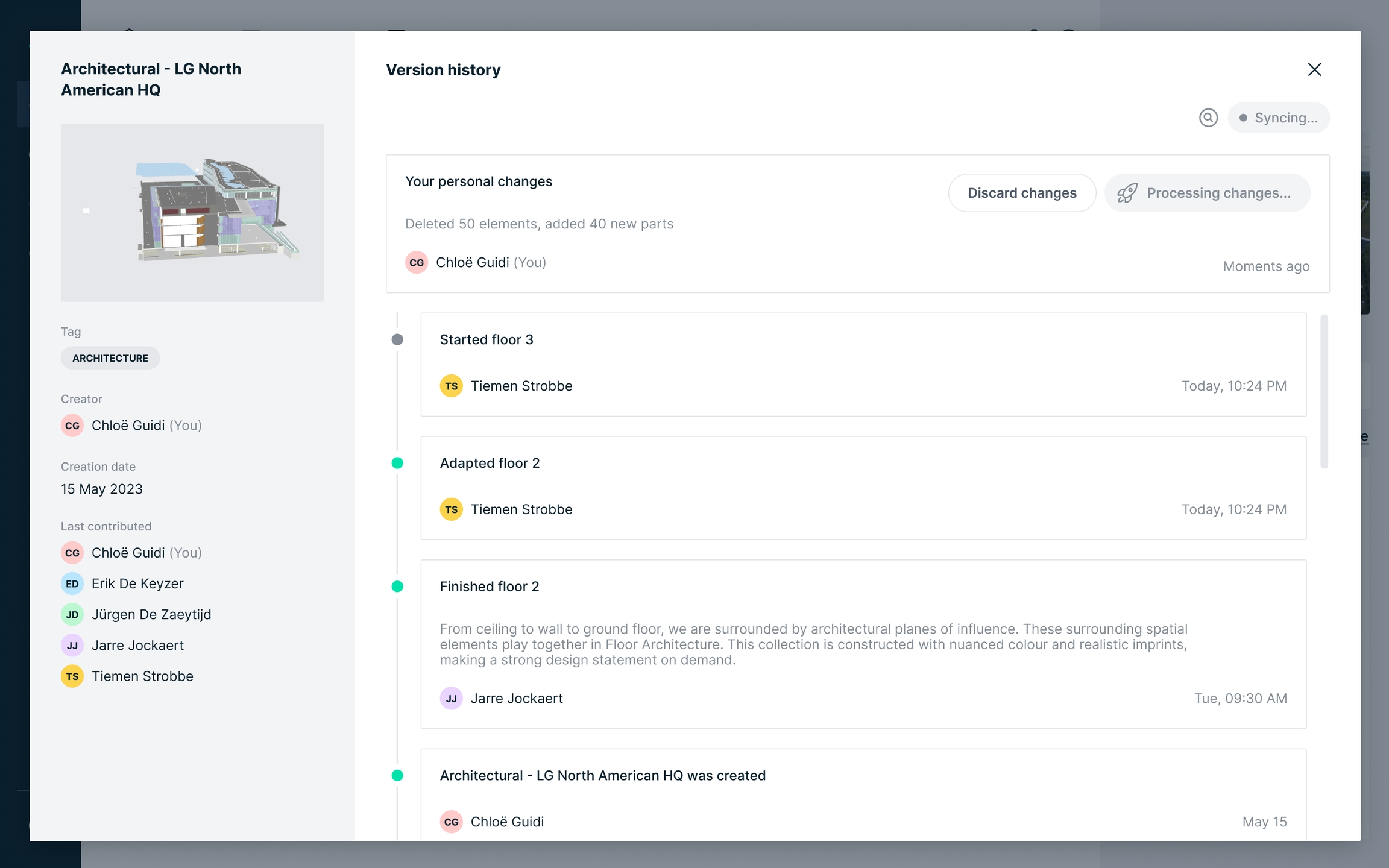

As soon as you have made a modification to a model, a personal version of the model will be created that contains these modifications. You will be notified that your changes are saved in the top-right corner of the screen. To make your changes available to other contributors you will need to publish them. To do this, click the Publish button in the top right corner of the project dashboard, or Review and Publish in the top right corner of the model application. When everything is published, the dashboard shows Synced instead:
This opens the Publish my changes dialog, which gives an overview of all components, models and shared project data where you currently have pending changes, grouped under Components, Models and Shared data. Optionally, enter a Version title. In the image below, one model was edited and another one was removed. When publishing, all changes across these different items will be published at once. You can still deselect the models of which you don't want to publish your changes yet; shared project data can't be deselected. To discard all changes in your project at once, open the options menu (...) next to the version title and choose Discard all changes.
Once published, your version becomes the latest public version of the model. Anyone opening this model will now see your changes, unless they have changes incompatible with your changes.
Collaborating
It is possible to work with multiple people on one single model at the same time. Because of the asynchronous approach of Qonic's versioning system, you will not see other people's changes appear in your model view in real time. Instead, whenever someone chooses to publish their changes, these changes will become part of the new public version of the model. If you see something like in the image below, this means that someone has recently published their changes and the server is still processing this.

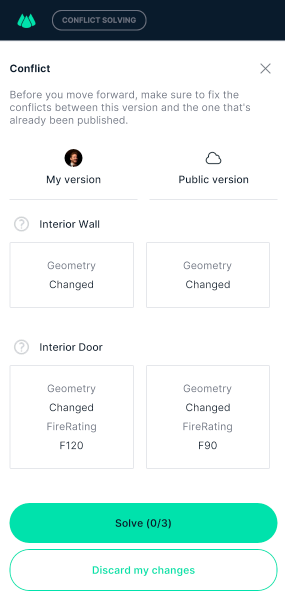

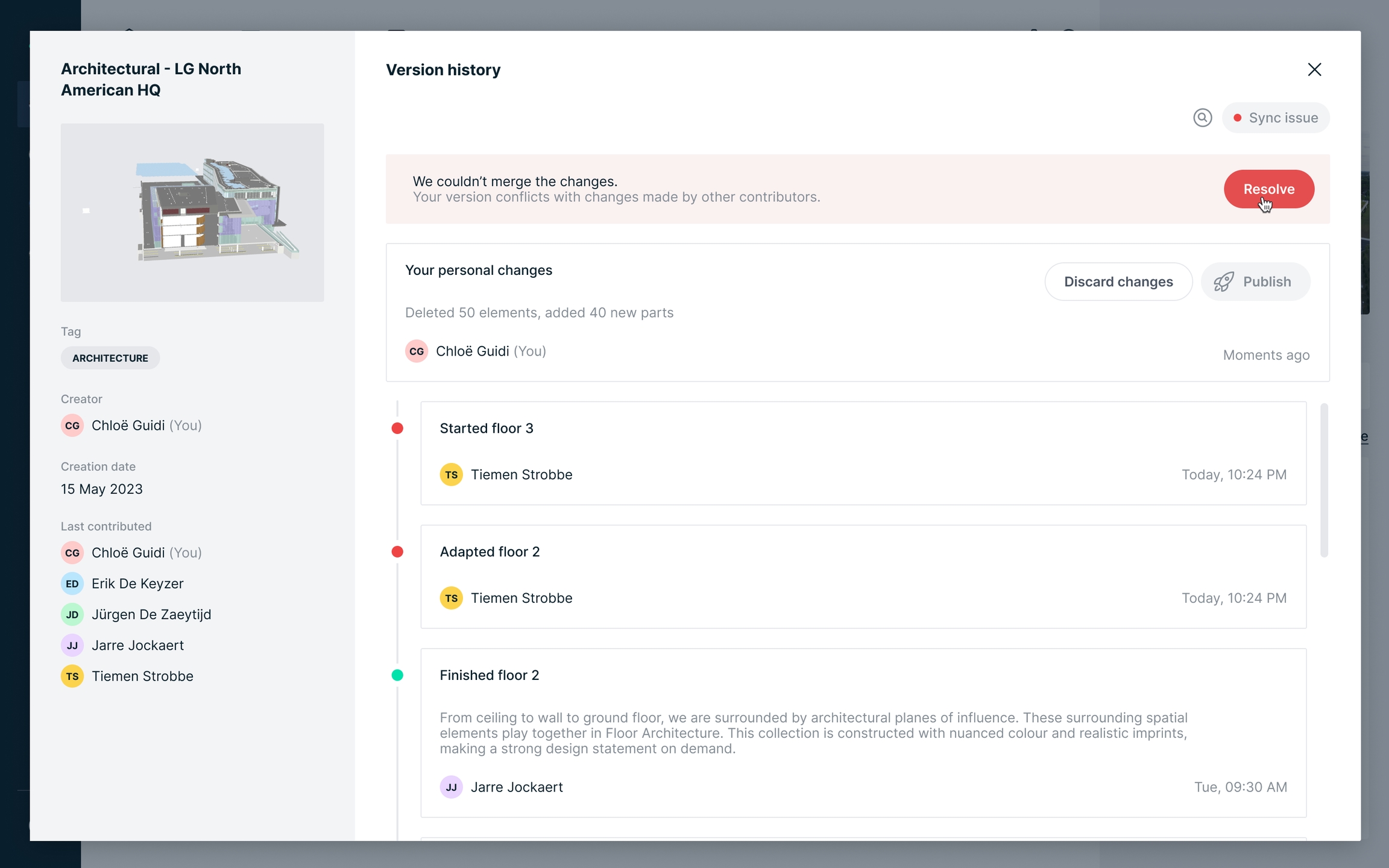

  • The changes that were made by the other person conflict with your own changes. You are notified by this conflict in the version history panel.
When this happens, click Resolve in the version history panel. You can either discard your changes or attempt to resolve the conflicts. This will give you an indication of whose version of the model your changes are conflicting with.
  • Discard your changes: you will lose all the changes you have made since you last published this model.
  • Solve conflicts: open the model in a dedicated 'conflict solving' mode. Here you will see a list of all conflicting changes, with an option to choose between the two versions of each change. On the left-hand side you will see your own version of the change, on the right-hand side you will see the latest public version of the change. You can solve each conflict individually by clicking either of the two options. Once all conflicts have been resolved, the 'conflict solving' mode will be closed and you can continue working as normal.

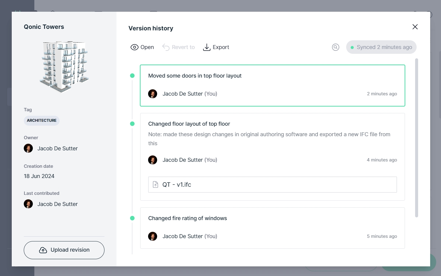

Qonic supports uploading revisions of IFC, Revit (.rvt) and Rhino (.3dm) files in the same version history of a model. In the version history of a model, click Upload revision in the bottom left of the dialog. Only model owners can upload revisions, and only when they have no unpublished changes on the model.
When uploading a revision, Qonic will not simply overwrite the previous version of the model. Instead, it will try to merge the changes that were made in Qonic and those that were made in the new IFC file. This way you can in fact simultaneously work in your original BIM authoring tool of choice and in Qonic, and use the version history in Qonic to manage and keep track of all these changes. If there are conflicts between changes made in Qonic and those made in the new IFC revision, the same conflict resolving method as described above will be available.
The upload dialog has an Overwrite changes with current model toggle. Turn it on to overwrite changes in the current model, or off to replace it while keeping earlier versions available. The revision is first added as your personal version; publish it to make it available to other project members.
