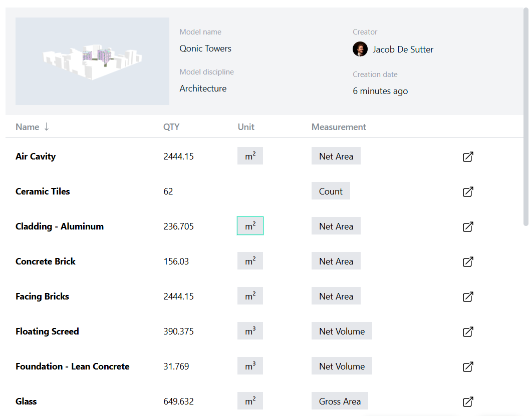

Reports can be created from a model to generate precise quantity takeoffs based on grouping and filtering rules.

Once a report has been created, it can be double-clicked to open, or you can select it and click Open. A report can be opened once its quantities have been calculated. You can view the entities that each row relates to by clicking the View in model button in the right-most column.
If a quantity can be shown in several units or measurements, use the dropdown in the Unit or Measurement column of that row to switch between them.
